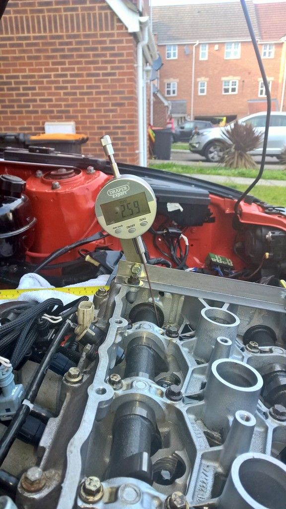

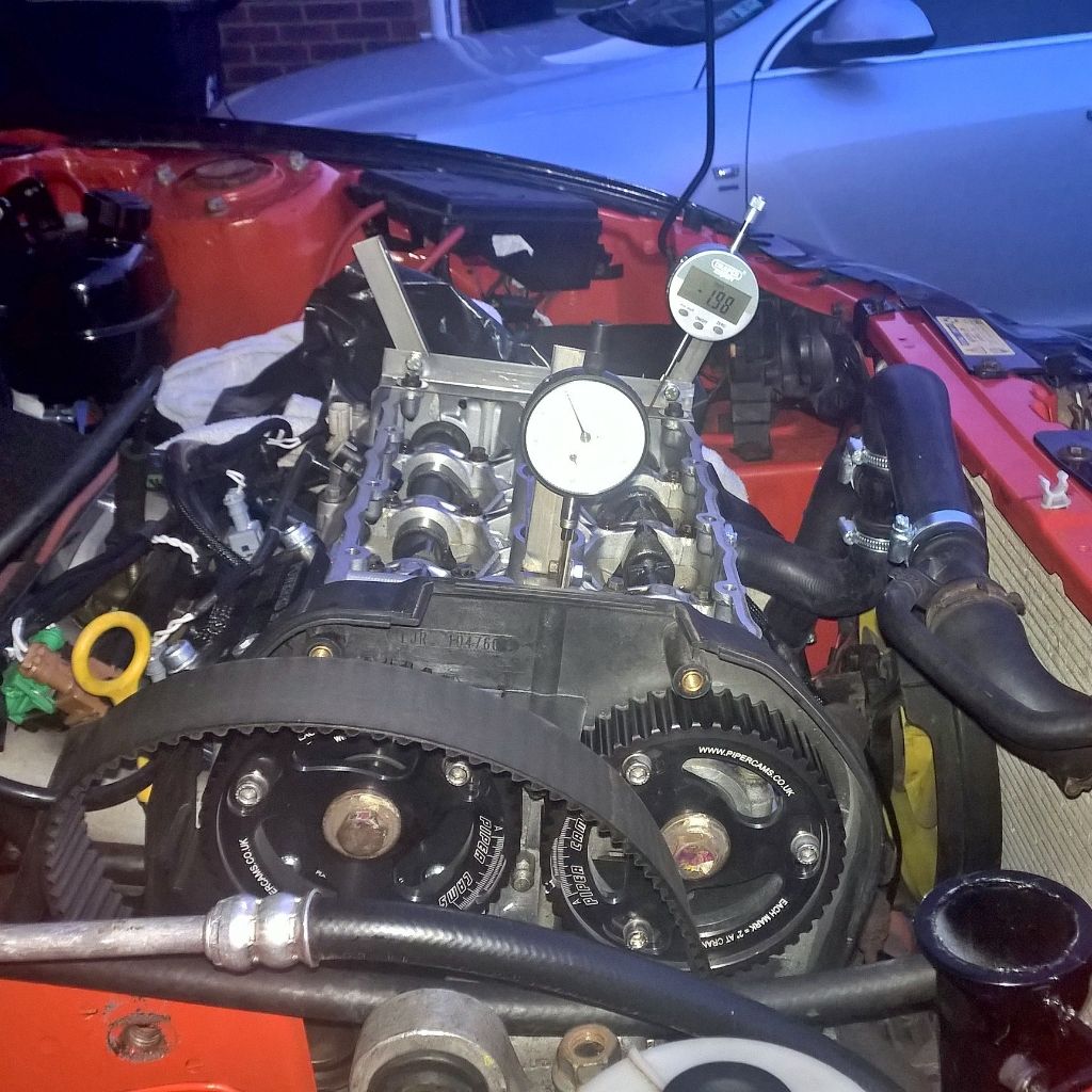

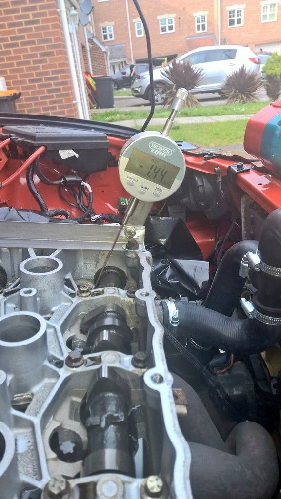

Ok for some reason forgot to update thread, mapping didn't go well the power and torque just keep dropping off so was obvious something was wrong. We did what we could in the time we had with the tools we had but to no luck. The mappers thought there to be a problem with either the cams being incorrect or the timing being out. So anyway after a week depression at the reasons i was close to getting rid of the car and being done with it but after a break away i looked into the problem. First rechecked compressions all reading ok @ 1-200psi 2-200psi 3-210psi 4-220psi. checked ecu setting, fuel pressure, throttle bodies etc etc everything was fine so onto cam timings. I didnt do this myself when built engine as i didnt have the correct tools/gauges etc to set up the verniers so i had a well known person (who im not going to name) do the job for me. After a few days waiting for the digital dial gauge etc to turn i could get on with making the brackets etc to get the job done. Using the "lift at DTC" method i carried out the job, below are the results and the settings....
Cam settings first....
Piper's setting Intake cam - 2.24mm DVA Powers setting for exhaust cam - 2.79mm
Piper's setting exhaust cam - 1.98mm DVA Powers setting for exhaust cam -2.41mm
And here are my findings....
Intake cam....
Exhaust cam....
So as you can see the exhaust is way out, im happy i had found the most likely course of the fault but not happy about being £200 down for the cost of 1 hours rolling road and mappers time.
Got it all reset now and run it up, the engine note is completely different now and it revs up a lot faster so be back to the rollers asap....

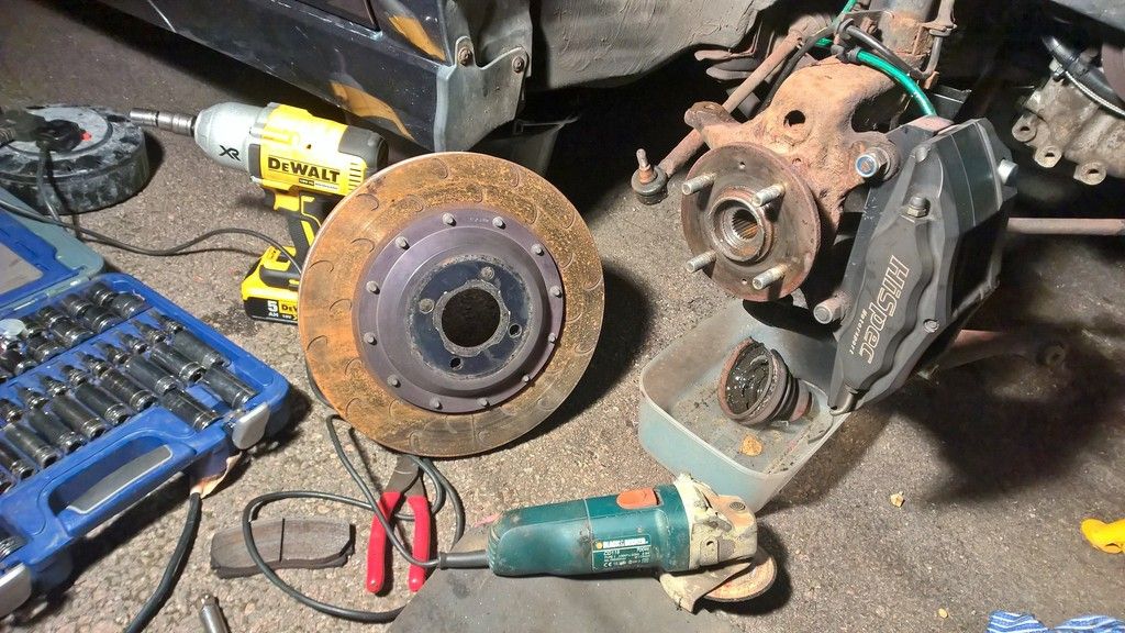

Also noticed i had a split c.v boot so be a cold one after work tomoz night getting that sorted.

Ok guys quick update on trackday. Started off Friday night carrying out emergency repair and replacing a split c.v boot at 8pm....

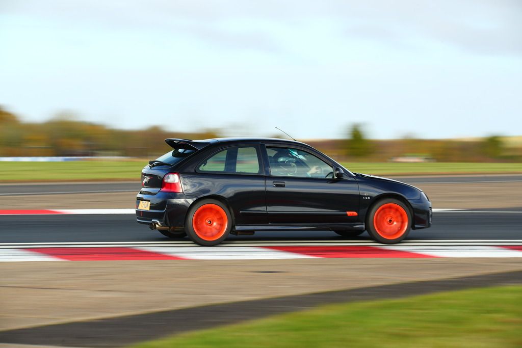

I'm glad to report the car was amazing, no problems to report, engine didn't mis a beat all day and pulled like a champ and only was passed by a 2014 M3, a new Focus RS and a 2015 GT3 RS and a set of piper cams wont do much against those. Had a really good day so looks like it all paid off in the end I had to be kicked out at end of day was only car left....

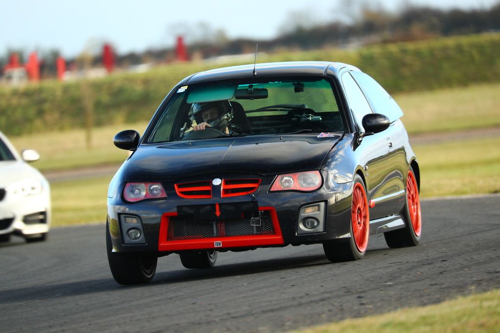

Few from a very dirty and slippery morning session at Snetterton 300 yesterday.....
