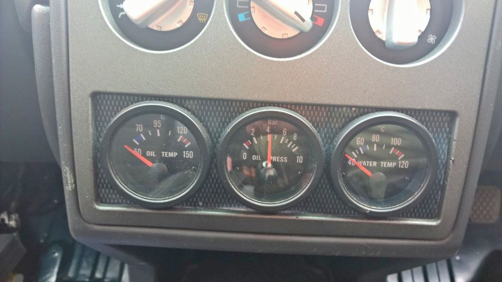

Got the oil pressure gauge all in today should have put new switch in really but to be fair nothing wrong with the old one just looks bit a tatty :p....
Oil pressure is good too....
