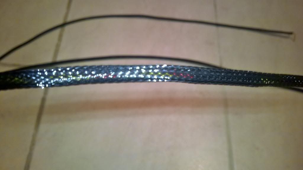

braided cable protection for inside

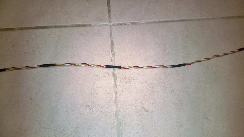

wiring the gauges
gauge wiring put into a female ISO plug so easy to remove if needed

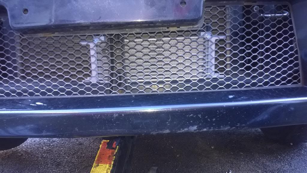

Ok so oil cooler parts in so just messing about with where to fit it :roll: A/C has had to go to make room for it but no problems there really ;)

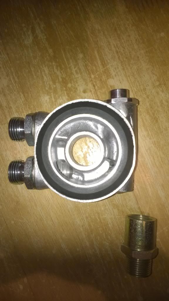

Mocal plate with 80 degrees thermostat
As you can see condenser takes up the cross member
Two places to fit now, on the offside is best route for pipes but if i fit it to the nearside will get air though on idle from the cooling fan
Been on a weight loss program today :smile2:
Went for a trip to local beakers today and picked a non a/c heater box and blanking plug for the evaporator pipes, the heating set up is in 3 bits fan housing on left, pollen filter housing in middle and the main heater box with matrix etc on right so if anyone wants to remove there a/c you only need the center pipe which you dont need to remove the dash to change :p dash etc all refitted now

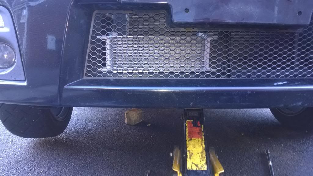

Cooler all in now ive mounted it so center of cooler is inline with center of the cooling fan so it can have air passing though in traffic/pits
Next was to mod the oil filter housing to take the oil temp/pressure sensors as ive had to remove the sandwich plate to fit the cooler take off

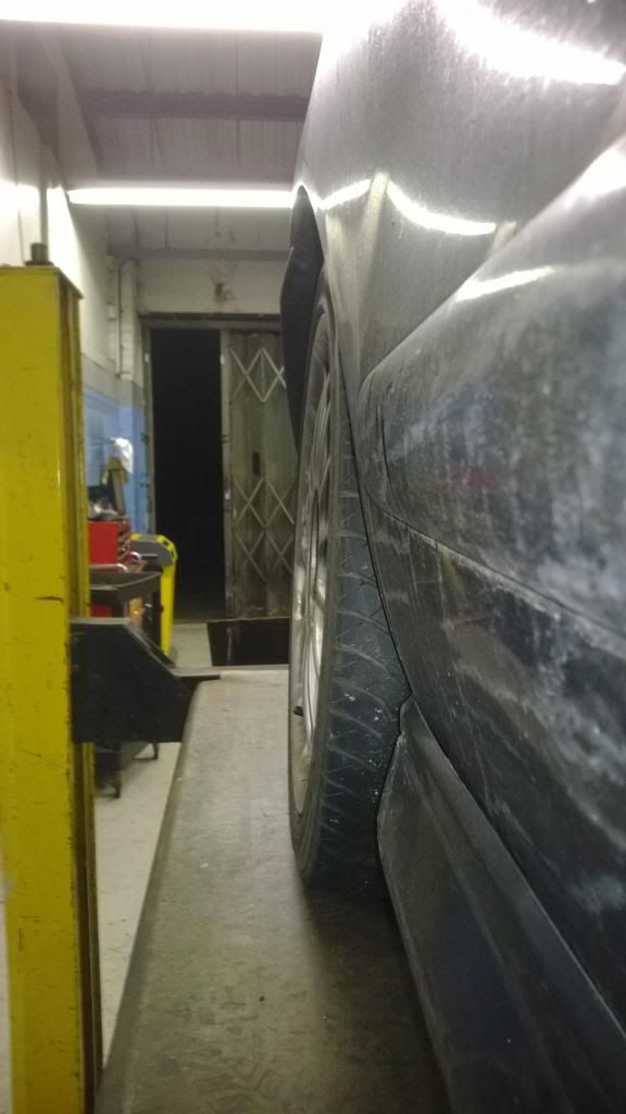

Ive also raised the bonnet thanks to a few Jag XJ8 exhaust manifold spacers :p
Quick update finally got all the oil cooler pipes made up, happy with it all and even made them up myself :p Defo made the right choice to mount it buy the coolant fan helps cool the oil while the car isnt moving ;) highest oil temp today after a hard run and holding rpm up to 3000 on the drive was 90ish so its looking good

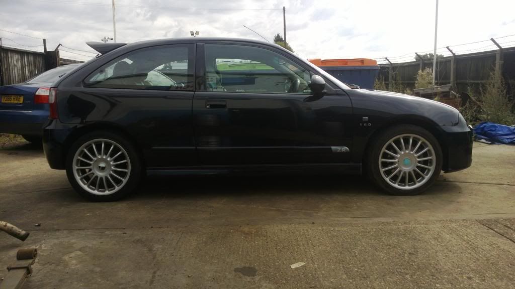

Got wheels fitted today at last, left them a week for paint to harden so should be good now. Really happy with how they came out bearing in mind have been done in my garden with only hand flatting and they were all curbed and pitted to f**k
