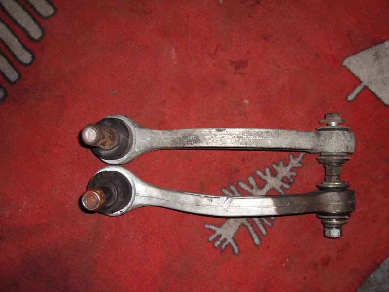

as the rear end had taken quite a hit, the hub carrier was broken (it had been welded when i got it, just to make it rollable), and most of the rear arms were bent and also the drive haft had come apart. Had a search around for the bits i needed and found them to be at extortionate prices. A friend who knows someone who rallies an evo then said he could get me all but one of the arms (the upper wishbone one), a drive shaft, and the complete hub/bearing carrier with hand brake cable and abs sensor complete for £150, they were from an earlier evo, so a few more miles, but the chap had just been keeping them as spares if he ever needed them. Steal imo!
A comparison between one of the original arms and its replacement.
Pic of the new bits (or old bits should i say).
Driveshaft ends are a bit different between the original and the replacement, the main thing i'll need to do is get the wheel speed reluctor ring swapped over, or the joint.
