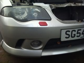

Well been thinking about it for a while, then went off the idea and was thinking of some smaller rover 75 washer jets or mazda 6 ones as i dislike the large rover 45 ones, so went scrappy trawling yesterday as it was £26 on ebay for 1 used rover 75 headlamp washer, no luck looking until i stumlbed upon a renault something or other(sazatche or something same size as an espace) with nice flat fitting pop up headlamp washers, result
so went back today and got both washer jet, all the pipework and the high pressure pump for a grand total of £18...lol
so just trial fitting one just now and im going to need to modify the crash bar slightly...no big deal infact will actually make them easier to mount
heres a picture of how its going to look, i was cringing as i hacked the bumper though i have to say
thoughts?:)

yeah:) just need to do some modifying to get the actual mechanism at the back to fit though

right few more pics, crash bar now modified(hacked) so the washers can sit correctly and so the bumper caps will sit flush to the bumper, need to tidy up the holes in the bumper with a file try doing that tomorrow during the day,
just back from halfords with fibreglass but unfortunatly its now dark so il wait till tomorrow to afix to the bar, really pleased with how its worked out so far,
piping and the washer units
how the washer unit will fit behind the bumper
imagine them silver and i hope thats how they will end up sitting all going well and good

done off hydraulic pressure, the pumps pretty meaty, its to pass the MOT as i have HID headlights they need to have washers, been told by the moter that the leveler switch in the car is suffiecient for the self leveling part so this is the best way i could see to do it, it should look better than the o/e setup when done, well i hope so anyway
