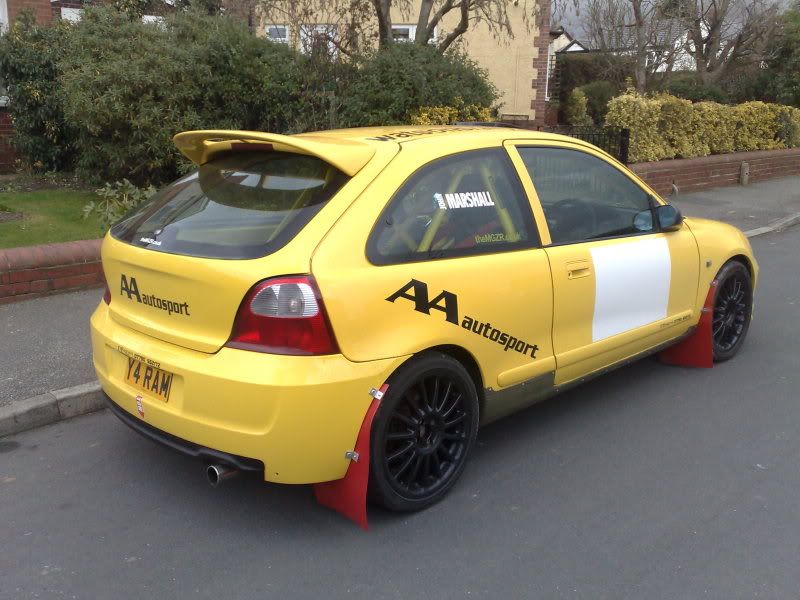

Took a nice pic tonight. Thought i would post it! :)
Looks great mate. Lot of time spend on it. Just a little thing if i were you id touch up the L-plates on the mud guards. Love the flocked dash

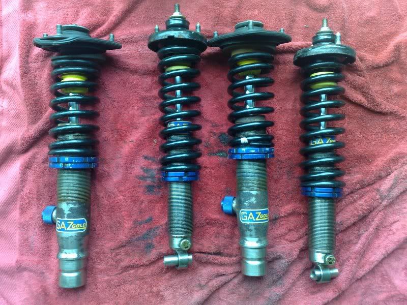

Well i managed to get some suspension sorted. 2 way adjustable Gaz Golds. I bought them from a lad who had them on his car for a month them it blew up. They hadn't done many miles, but then were stood for a while untill he eventually broke the car. They currently have tarmac springs fitted, but will get gravel springs too. A bit of a billy bargain. Gave them a good oil/clean and then fitted them. They seem very good from just a quick run round the block. :)
Fitted. Nice and stiff! :)
John
Which kind of rallies you are going to drive. This supension has so thin front shock piston, looks like about 20 mm that it can`t stand any hits. Wheel travel is looking very special short. If measured from the picture must be near or even less than 100 mm. This setup is good only if driven on absolutely smooth tarmac.
Don`t waste time to install gravel spring on these, specially if you have to buy new springs. On gravel the grip is done of course by right kind of spring rate and shock valving, but also by max long wheel travel.
Compare pictures about my suspension in my gallery. Page 22. It is made only for ultra fast driving on gravel or snow. Front shock piston is 50 mm thick to take hits without bending. My wheel travel in front is limited now to 190 mm for 65 cm winter tyres. I must use std bottom arm and ball joint but next season with new rules we can have more travel out, which will make car faster.
In rear my wheel travel is 200 mm. In your new suspension wheel travel is shorter that in std ZR 160.
Don`t wait too much from this set up on gravel or bumpy tarmac.
If you want to have right kind of spring rates for rally ZR send a PM to Rally Matt. My spring rates are far too soft for Brittish taste.
I am with Snowy here too, they are way to short travel for anything other than a track day car. If you are attacking corners on even a smooth (no where in UK is smooth!) they will snap like carrots, I know its what you have bought but Gaz have an awful reputation for pistons bending.
I would be most worried about the travel, they are just way too short, you will loose so much grip and car will skip about like a pig or as the french call them R5 GT Turbo. The big asset of the ZR is the suspension, long travel with coil overs at rear and struts on front.
Leda are very very strong, even serviced s/h ones would be a good bet. Then you can look at Avo who use same inverted principle as Bilstein invented, these are even stronger. Don't go too hard on springs, many do and loose so much potential. Also run car higher than std ZR ride heights for best performance on UK stages.
I tested special Bilstein set up on Jorma's ZR and also a BMW 325 RWD in Finland, it is excellent and you can attack the stage with total confidence and it responds perfectly, Timo of Bilstien Finland really knows how to build proper rally suspension.

Thanks for the input.
The GAZ's are a make shift setup really as funds don't stretch far atm. Matt - if you come accross anything going that would suit me, i would appreciate it if you could pm me or something... I want to do a mixture of Tar and Gravel. I almost bought some Ohlins a while back, but got beaten to them....
I was intending on using the car with the GAZ's for single venues, just to get some miles under my belt. I always had doubts that they would be durable enough for forest stages, even though someone from GAZ said they would be ok. He mentioned a few of the Revival cars run them?? I know the revival cars are very different to stage rally cars, but they tackle similar surfaces...??
I'm pleased i'm getting input - that's why i made this thread. This is my first build, so i'm looking for guidance where i can!
Thanks
John
I know the feeling. Passion for building a rally car, but limited budget. Have been " in there " many times.:twak2:
How it hurts the only right order to build the car ( after donor car and safety parts ) is : at first good suspension build for rallies to come. If wheels are not staying on ground your ZR will be hopeless to drive. At the same time you should instal Powerflex push set ( whole a lot of them ) and have a professional 4 wheel alignment.
The next thing is a gearbox with proper competition ratios and final drive. Before installing it into the car you need a LSD. Not a track day torsen, a real plate lsd. The best for PG 1 is made in UK.:racer:
Then the best brake bads for 160 brakes you can buy. Any kind of EBC is forbidden. After that comes all common staf ( lamp pods, guards, fuel lines etc ).
The last thing is the engine. Good gear ratios are worth of 25 hp in wheels, that is why gearbox comes in second place.
I did not buy Öhlins, Reiger or Proflex. 7000 £ is waste of money if not driven seriously for the championship. About that money I could buy my suspension and a dog box. And still capable to tease Civic boys.
Buy the suspension from a company which can re valve your shocks at once.
When you change spring rates shock valving must set for new springs to get any benefits.
If you are going to drive on tarmac and gravel the same set up as Rally Matt has, is a compromise good enough. For gravel only spring rates should be one step softer.
Don`t hesitate to ask, we will help where we can.
